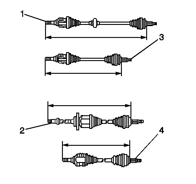

Ещё кое что.
Measure the right hand drive shaft to ensure that the shaft is at standard length before installing the boot clamps.
Specification
Right hand standard drive shaft length for:
• 2WD models (1) is 843.3-853.3 mm (33.201-33.595 in).
• AWD models (2) the standard length is 855.0-865.0 mm (33.661-34.055 in).
Measure the left hand drive shaft to ensure that the shaft is at standard length before installing the boot clamps.
Specification
Left hand standard drive shaft length for:
• 2WD models (3) is 577.3-587.3 mm (22.728-23.122 in).
• AWD models (4) the standard length is 566.9-576.9 mm (22.319-22.713 in).

CyberSergey писал(а):Ещё кое что.
Specification
Specification
верхний похож на мой. и бабышка по середине вала как у меня на фото. это что такое? откуда?
